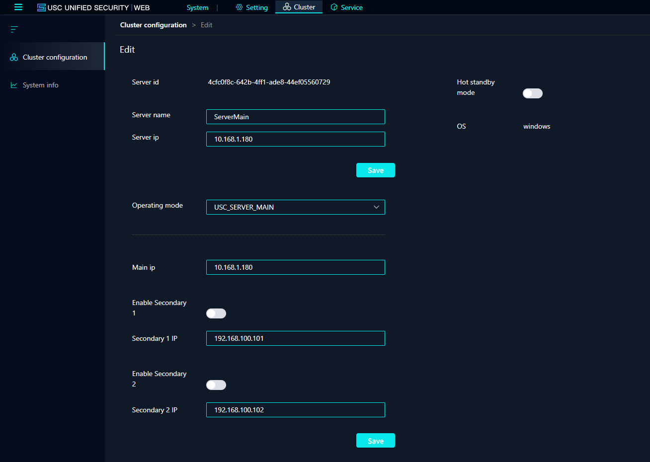

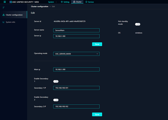

ServerMain USC_SERVER_MAIN 10.168.1.108

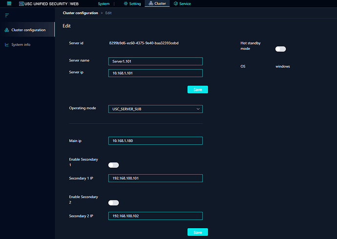

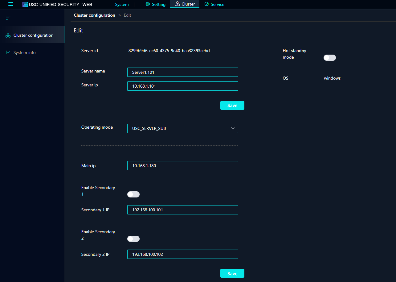

Server1.101 USC_SERVER_SUB 10.168.1.101

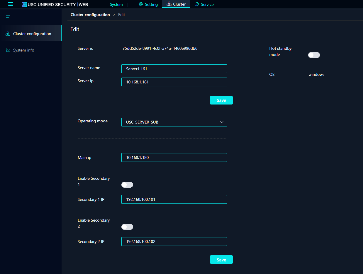

Server1.161 USC_SERVER_SUB 10.168.1.161
Edit this in System → Cluster → Cluster Configuration
  1. First, configure ServerMain, then restart the service. Only configure the numbered parts 1, 2, 3, and 4.
  2. Then configure the Server1.101 node, and restart the service after configuration. Only the numbered parts (1, 2, 3, 4) need to be configured. See below for reference.
  3. Then configure the Server1.161 node, and restart the service after configuration. Only configure the numbered parts 1, 2, 3, and 4. See below for reference.

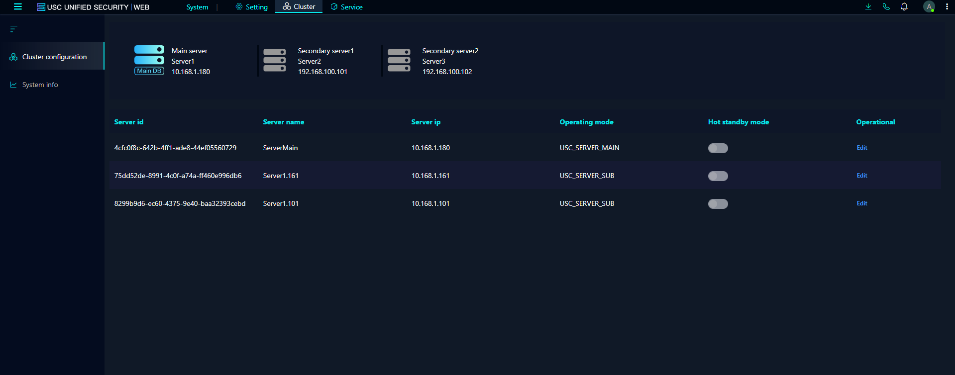

  4. After configuration, you can log in from any node to view the overall system status. You can see a list of all nodes under System → Cluster → Cluster Configuration.
